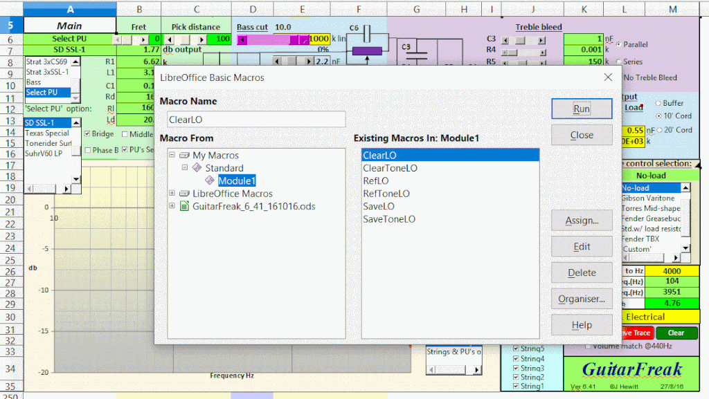

As promised, I tested Guitarfreak_6_41_161016.ods in LibreOffice under Windows and got the same results with regards to the 3 buttons on the main sheet. LibreOffice looks for the buttons in Module1 but "clear" is in Module10, "ref" is in Module11, there's no match for "save" or "save trace". Thanks for investigating. I get very little feedback on how GF works for others, so it is always appreciated. I downloaded the same file as above from the link, and it keeps working fine for me. The macros for the three buttons on the Main and Tone pages are indeed Module 1, as follows: The macros that they call up have the letters LO on them, to identify that they were added for the LibreOffice version. There is a separate set of three for use from the 'Tone' page, so it returns to 'Tone' after pasting to the 'Chart' page.Do you see them on your system? Also, what version of LO do you have? The file is also full of lots of excel macros (many are now redundant), which came over when I ported the Excel version into LibreOffice. Excel macros generally don't work in LO, since it is a different code format, though they can exist in the file. maybe I should delete them? Call out to others reading this: Anyone who has tried the LibreOffice version, or is willing to do so, I would be very grateful for feedback on if it works for you. It needs the latest fresh version of Libreoffice, and what we are testing here is the three main 'Save', 'Reference' and 'Clear' buttons. LibreOffice can be freely downloaded here: www.libreoffice.org/download/libreoffice-fresh/with thanks John

No I don't have these LO-macros in My Macros - Standard - Module1.
Now I'm not sure about this but my guess is that this Module1 is not part of the Guitarfreak ods-file but a local file. I found a Module1.xba file on my Linux-system in ~/.config/libreoffice/4/user/basic/Standard/ . Perhaps you know a way to include the macros in the ods-file, John, to make them appear under Guitarfreak... - Standard - something.
Post by JohnH on Oct 24, 2016 14:26:25 GMT -5
Ok thanks I think my next move will be to find a fresh machine to put LibreOffice on, and test it just with the downloaded .ods file to see if those Macros are there or not.

Post by perfboardpatcher on Oct 30, 2016 5:59:07 GMT -5
Yep, the macros work! "Save traces" is indeed a very useful addition to Guitarfreak. I'm going to experiment with recording macros to build in the same functionality in my spreadsheets.

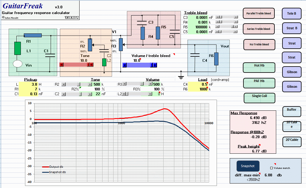

I have just edited the first post, to update it and add Version 3.0. The main new thing is a 'snapshot' button, to allow two settings to be compared. See the first post for more info, and download in current Excel format here: GuitarFreak3.0cheers John Retrieved image.

I just thought I’d share some ‘work-in-progress’ on the GuitarFreak spreadsheet. See the first post on this thread for the current finished version GuitarFreak3 For the next iteration, GuitarFreak4, I want to add a few extra capabilities, so it can help with the design of some more of the non-standard configurations that keep coming up on GN2. In particular, I'm thinking of series wiring with part bypass of one coil or one pickup. This will help check out systems such as ‘spin-a-split’, ‘broadbucker’ and general part bypass with caps and resistances, to find tones between single and humbuckers. All of this can be done on modelling programs such as 5Spice, but the advantage with these spreadsheets is to be able to put the main controls on slider bars, and view the graph of output interactively as you tweak it in real time – the previous GF’s have this. So far, I’ve got the main coding done, and alpha tested, with fixed numerical inputs (no slider bars yet). I think it works, but needs QA. This is the sketched schematic that i’m working with. There are two coils each with inductance, resistance and winding capacitance, and each with a set of caps and resistors to bypass them. I run the numbers by analysing the output from one coil at a time, and adding the two parts together. It’s done by considering the circuit as a network of impedances, as you would a resistor network, but calculated using complex numbers to pick up reactance and resistances. I could explain more but that would depend on anyone wishing to know more. Here’s a plot, with no bypass on the coils, to represent a full humbucker. Here it is with the lower coil fully bypassed by a 1 ohm resistance, ie its a simple coil-cut And here is a more interesting part bypassed arrangement, of the type that this system could potentially investigate quite easily. In this case, the lower coil is bypassed by a 12k resistor and a 10nF capacitor. See how the peak is like the single coil version but there’s more low end tone?. The next step is to test this against a 5Spice model to check, and then add all the interactive bells and whistles to make it quick and intuitive to use. But before I do that, (and the reason for this post), I'm interested in any opinions as to other features that could be built into the schematic. It would be fairly easy to extend the code a little more at this point. They should be things that can be adjusted by component values rather than switching, and which have come up more than once on the forum. Eg, I’ve got the inductor in the tone circuit, so that varitone arrangements can be tested (will that capture it?). Also thinking about a bass cut control? Any other ideas? Cheers John More retrieved images. They all need to be copied/saved. Every example has worked so far. I'll leave it there - I'm messing up threads.

It's been about a year since I last added to GuitarFreak and the latest version is now GuitarFreak 6.5 whch I just uploaded: GuitarFreak6.5 (excel 2007)New features in 6.5 include the following: - A considerably expanded range of pickup models, both as complete sets and individual pickups
- An additional resistor added to the treble-bleed network to enable a new option of the Fender Tonesaver circuit, as built into current 2017 stock American Stratocaster Pro models
- A few minor tweaks and bug fixes
The pickup models are all based on the detailed testing by Antigua, and huge thanks are due for his diligent and comprehensive work. For GuitarFreak, only a small selection is included, mostly cherry-picked to cover the main types focussing on well-known and classic models. There are several LP, Strat and Tele versions, plus new for 6.5, two Gretsch-based sets (Filtertron and TV Jones) and a combined Jazz/Precision bass.
See below for all test results: guitarnuts2.proboards.com/board/30/pickup-testing-modelling If anyone running GF wants to use it with other pickups from the testing archive, let me know. it doesn't take long to derive the models, though it is not an automatic process.
For the Bass model, which has a 34" scale, the N and B pickups represent the J-bass with pickups in their classic positions, while the M pickup is the single P bass. pickup, with the treble side of this split PU defining its position (adjustable). To properly use the bass model, set the A string to 55hz on the 'Strings and Pickups' page, and use strings 3, 4, 5 and 6 for a four-string bass.
GF was first written to investigate treble-bleed circuits, so when Fender started to build them into their stock US models, I wanted to be sure their design can be captured. The Fender TB circuit is a parallel 150k/1.2nF R & C all in series with another 20k resistor. There is now a dedicated option button in GuitarFreak for this, since I suspect it will become the most common TB design on any stock guitar. Ill run some comparisons in another thread soon. Linked above is an Excel version for Excel 2007 and later. I'll be happy to post 1997-2003 or Libreoffice versions if requested, but particularly the Libreoffice version takes significant work to manually update to match the Excel. But Version 6.4 linked on page 1 is in all formats and pickup data can be copied in as needed.
