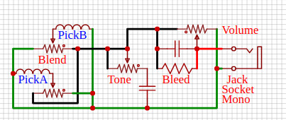

Post by Deleted on Nov 19, 2021 4:08:13 GMT -5
hmm I think Back to Basic, need to look at Tone, Volume and Blend and what you need and should look like. I think asking for a Truth Table for this circuit is taking the P really Main point is Jack Red & Black are Linked together

Post by Deleted on Nov 19, 2021 9:21:28 GMT -5
I do think Circuit Diagrams will help you Follow a Path from Pickup to Jack! I hope this Shows what a Blend Pot looks like, Tone Pot , Volume Pot and The Mono Jack Socket
